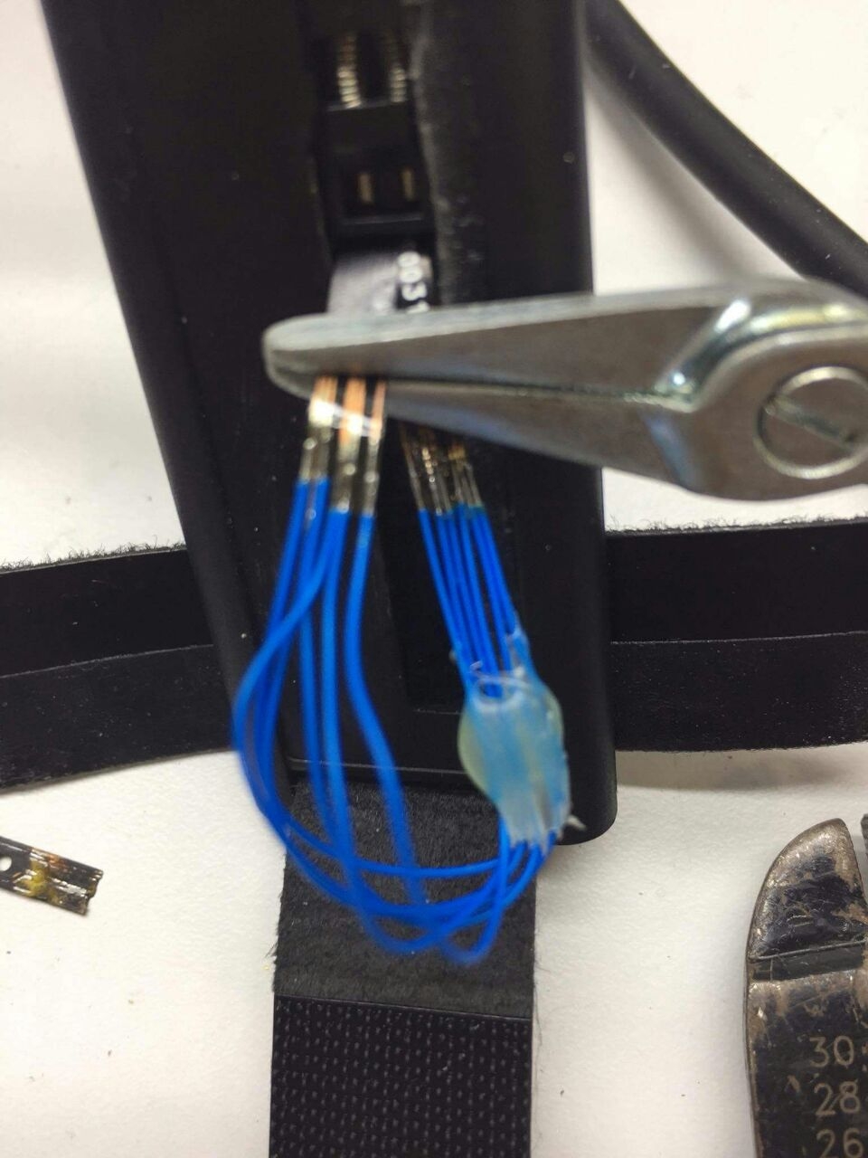

I tried amend the ribbon cable using wires but when I test continuity with multimeter any pin doesn't work.
1- Before try fix, I tested continuity between this pins and the headphone pins, it's working.

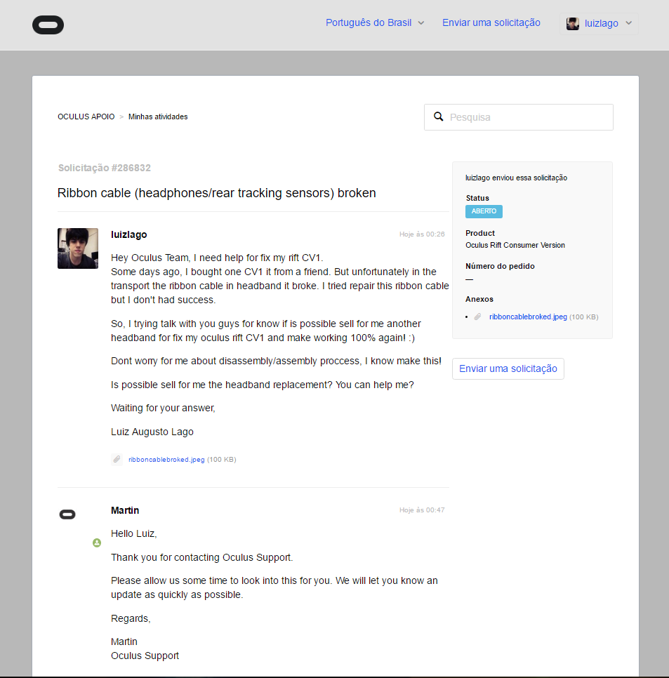

2- I received the oculus in this situation. I needed cut the ribbon cable after this hole because was torn.
3- Conversation with the Oculus Support Team
3 - Soldered pins with wires in the both sides, at the moment, all that's fine. I tested again the continuity between the blue wire sides, it's working too...but if a test between the blue wire side and headphone contact...not working :( (maybe why I use this wire? need another wire type?)
4 - Another picture without zoom
