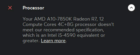

Hi,
Recently I tried a Oculus Rift at a friends house and absolutely fell in love with it. The only problem is that my oculus compatibility test has come back with not so positive results. As someone who is just getting into virtual reality would i still be able to run Oculus even with my processor? (also every other category was green)
  • ScouseSeattleScouseSeattle Posts: 15

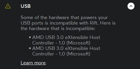

    When I received my Rift, I tried installing on an under-powered PC, the installation would not precede.
    For the USB warning, you can buy an add-on card, or try some of the USB 2.0 ports on your machine. However, that CPU is not compatible, as far as I know, so you may not even be able to get it to work at all.
  • OmegaM4NOmegaM4N Posts: 661
    CPU is fine but that intergrated GPU is just not powerful enough for VR, you would need to buy a video card to replace that intergrated GPU.
    And as for your USB a inateck card would be the way to go to solve almost all your USB issues.
  • CongratulationsCongratulations Posts: 120
    No you can’t you need the minimal requirements.
