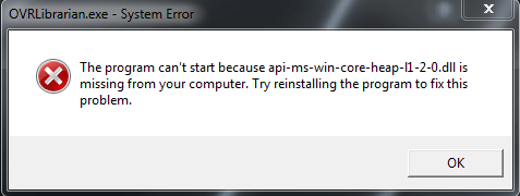

After downloading and running the installer on Windows 7 SP1 I am presented with this error:
After clicking OK the installer opens and works as intended untill the Installing part takes place. The same error pops up and upon closing it pops up again, making it impossible to proceed. The weird part is every time I turn on my PC this same error box appears. The specified dll file is not missing from my C drive.

    Okay this time the installation finished successfully, although on each restart the error always popped up. But now after trying to open the Oculus app I am presented with another error:

  • HeadedSpyHeadedSpy Posts: 7
    Upon opening it the same "missing dll file" showed again.

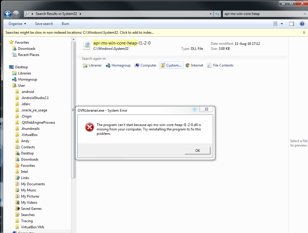

  • LZoltowskiLZoltowski Posts: 6,705 Volunteer Moderator
    edited March 2018
    Try this
    open CMD prompt as ADMIN (this is important)
    type in regsvr32 /i C:\Windows\System32\api-ms-win-core-heap-l1-2-0.dll
    also out of interest is the file api-ms-win-core-heap-l1-2-0.dll present in the Oculus folder?
    Oculus\Support\Oculus-Client\
    api-ms-win-core-heap-l1-1-0.dll is present but not the 1-2-0 one
    I get this error when running the command:
    I checked on my computer and on a VM of windows 7 I use .. I cannot find that file! Something went super wrong on your system. The only thing I can suggest now is doing a full windows re-install. Making sure windows is fully up to date, running any KB updates, making sure you install ALL the distros in the previous post and run setup again.
