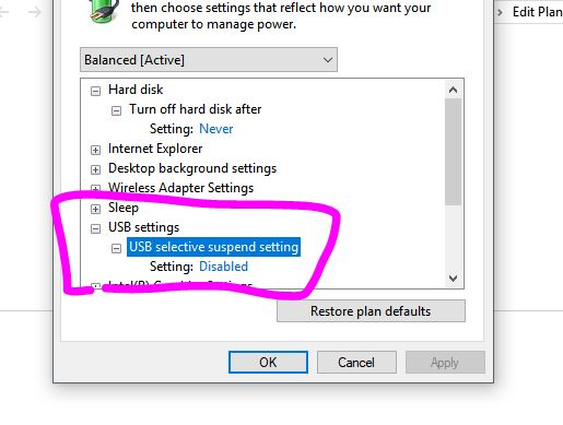

    Also in Power Plan settings:

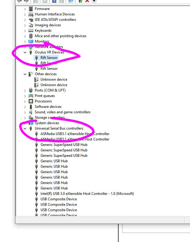

    Hi everyone,
    today i received my powered USB-Hub, but it always did disconnect.
    The sensor is the powered Hub on both pictures, but it seems like he changes his ports to 3.0 to 2.0, wtf?
