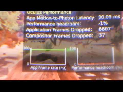

Having a look at the picture in the VR environment, looks good, but I cannot help to think it looks a bit 'grainy'. Especially in the Home environment. I wear reading glasses and have tried with and without them, and it seems clearer without, so I assumed its a performance issue. When I activate the Performance HUD in the Debug Tools, it shows I am sitting in the low teens to negative headroom. I was expecting it to be a little better than that. THis is without adjusting the pixel density setting that everyone raves about as being the 'ultimate' setting.
I am just a little disillusioned about this, and have been wanting this setup mostly to do flight sims like wwar thunder and Il2. It just seems like it is a little too 'unrefined' though.
Is it me having these problems due to a setup mistake, or is it normal. If you look at this video, it seems that even on a GTX1080, there is still not the headroom expectation that I would have. 1070 looks to be similar to what I am getting.
Thanks in advance....

    He's banned mate, surprised you didn't want any brain elixir  :D as for your post, your system is more than fine. Have you tried super sampling with the Oculus tray tool to get that little bit of clarity? What you are seeing as standard is pretty normal for this round of headset mate ;)

    Ok, I see that other people have had the same problem, and I am trying to figure out how I can get the system running well enought to support longer gameplay. I was trying War Thunder last night after I posted my question, and it was running ok, but I think I need to tweak with the WT in-game graphics. When I got into a plane and was just flying around for gits n shiggles, was having a blast, but then I changed into another plane and started getting a LOT of tearing/smearing. I exited the game and noticed the GPU fan wasnt running very high, but the temp was up at 76DegC!! I dont know why, but the system was not responding to turn the fan on.

    Appreciate the feedback. I am using the ASUS Tweak tool, and it was set to auto and was working previously. I think I found out what the problem was. My old MS Sidewinder FF2 Joystick was the root of the problem. Once I plugged that in, it causes problems. I dont know why, but I isolated it to that, so plugged in the X52 Pro and everything is working like it should. I have used the Oculus Support Debug tool and have set the Supersampling to 1.4 max, as I am not sure how bad it is affecting the GPU. I will try it at 1.5 and see what sort of results I get..
