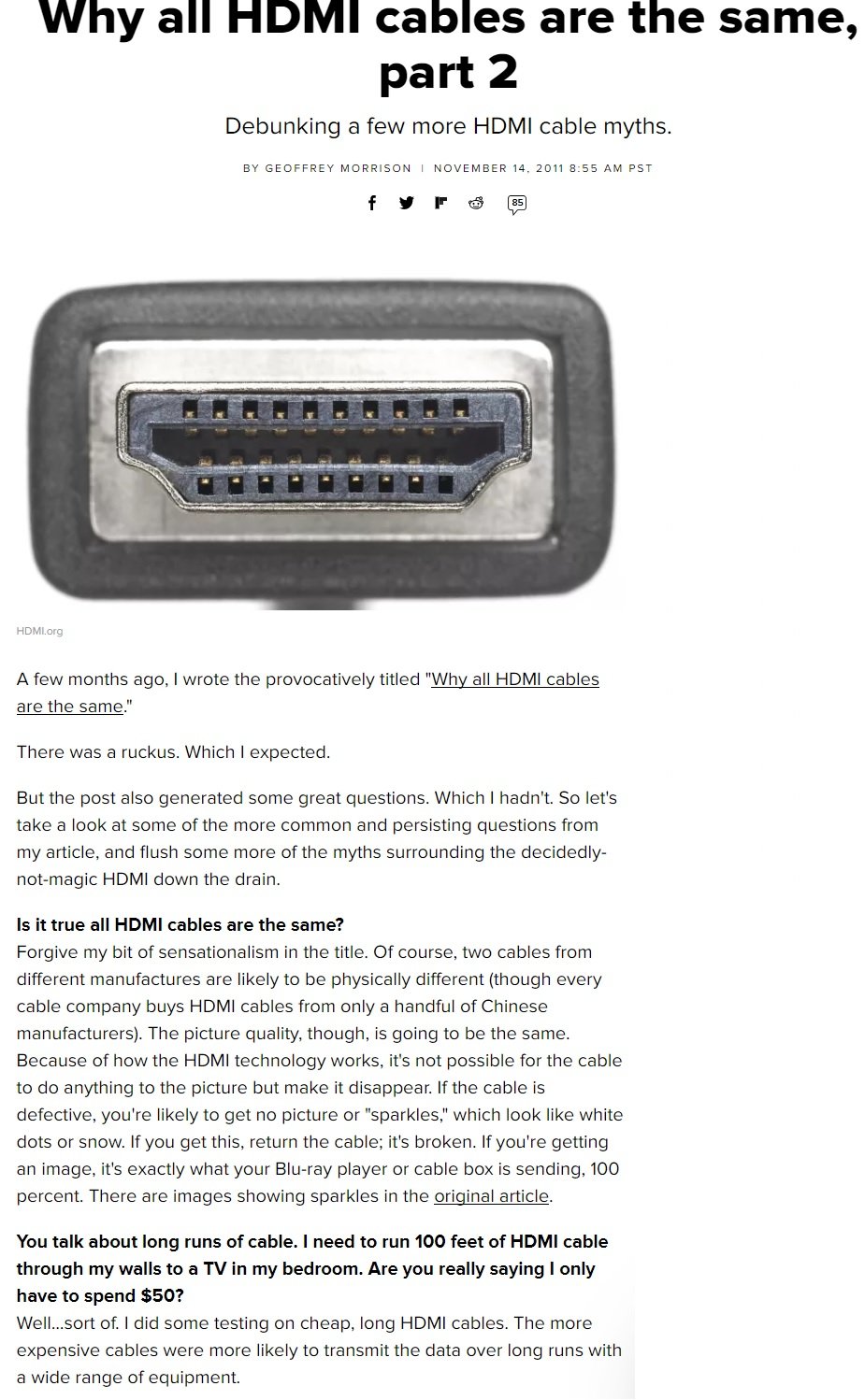

Next thing coming up: are high-speed HDMI cables really the same? Some authors have suggested so - and in some cases it may of course be true, like:
Source: https://www.cnet.com/news/why-all-hdmi-cables-are-the-same-part-2/

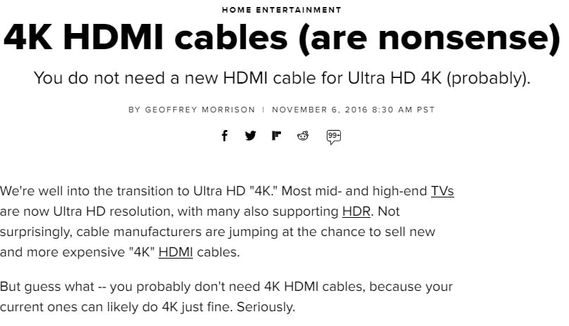

- and:
Source: https://www.cnet.com/news/4k-hdmi-cables-are-nonsense/

"It's important to remember, there's no such thing as HDMI cable "versions." There's no such thing as a "HDMI 2.0 cable." The version numbers refer to the HDMI connections in your gear. Which is to say, your TV can have HDMI 2.0 inputs, but your HDMI cable is just an HDMI cable. Any High-speed will do. So even if you bought a High-speed cable when all your gear was 1080p and HDMI 1.4, it will probably work now with 4K HDR and HDMI 2.0a gear."
