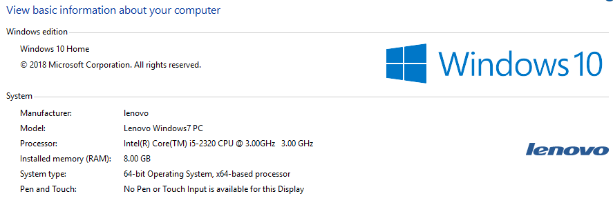

Hello, Everyone I've been trying to connect my rift since it came out. It doesn't seem to be recognizing the headset at all. When I first got it I connected it and it had an orange light. I proceeded to the setup and installed it, it said I needed to update my graphics drivers so I did. After this is has been stuck on connect your headset screen with no recognition.
What I've tried:
Uninstalling and reinstalling.
Deleting Files and Reinstalling
Repair set up
Checking for drivers to update.
Checking for Windows Updates
Restarting computer
Changing USB and Display ports locations (made sure it's on my graphics card)
Unplugging and replugging cable on Headset itself
Any Advice Would be greatly Appreciated
Graphics Card:
EVGA GeForce GTX 950 2GB SC Gaming, Silent Cooling Graphics Card 02G-P4-2951-KR

    That card is way below recommended specs and will not run the rift sadly :(

    Your whole system is really weak for VR mate so I'm not sure just a graphics card would help. As I said though, a 950 is below spec and that's why it's not being picked up.

    As for your PC, I think your cpu should be ok. But as to what you want to upgrade too then it's all about your budget. I'd see if you could borrow a higher graphics card and check if it works ok first ;)
