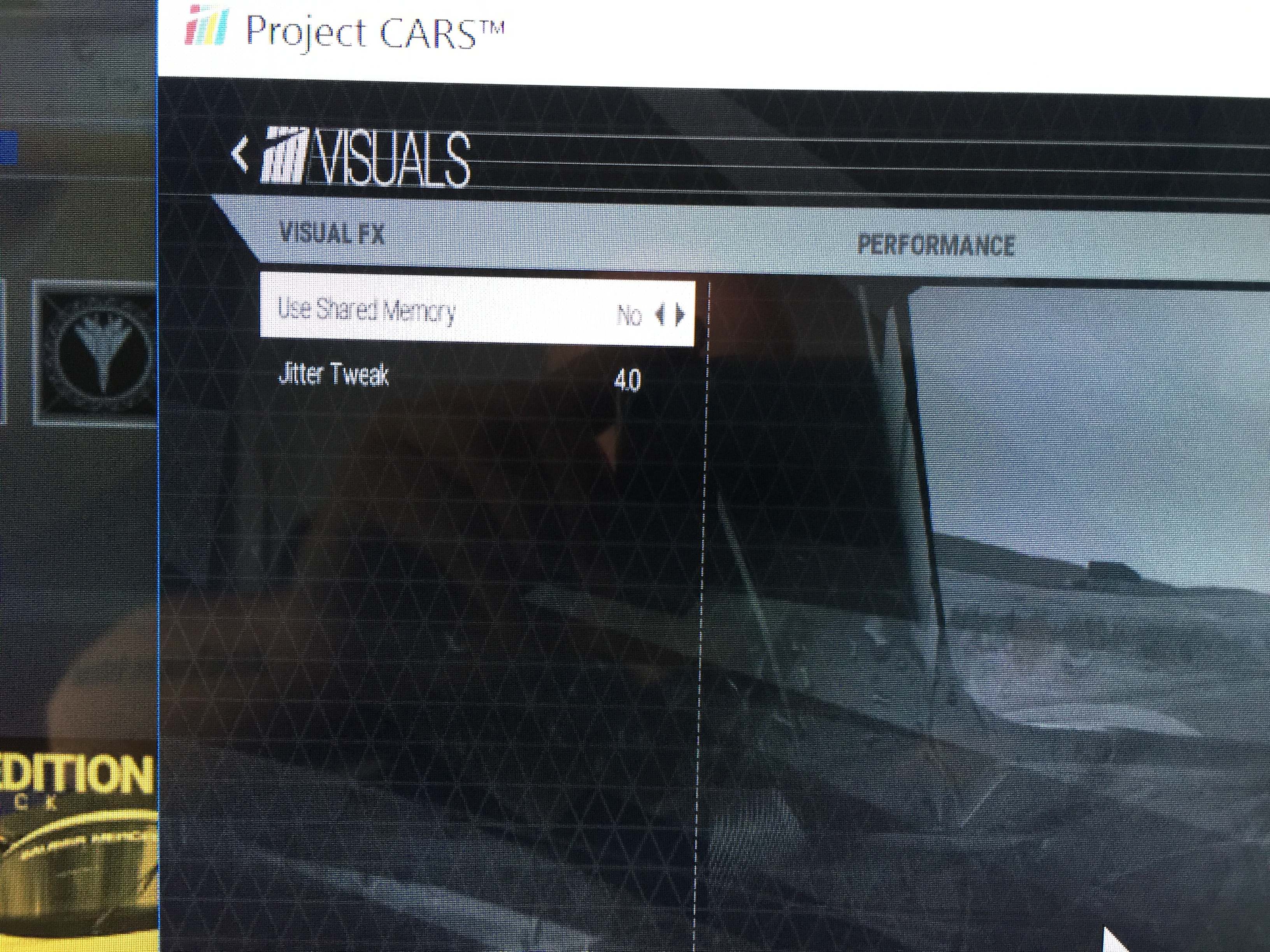

I was originally having trouble getting Project Cars looking and playing good after the last update, Ive finally got it back to the way it was before. Ive still got to mess about with some of the Visual FX settings to see what makes a difference but here is the settings I have at the moment and its working great on my system. I think the main culprit to why I was having issues was the grass setting, I will try that a bit later on. I just raised the graphics gradually restarting the game each time and making sure it wasn't juddery. If anyone else wants to post up there settings along with there system specs that would be great so we can trying and make improvements here and there...
I should note that I thought the resolution setting affected the HMD but I tried a few different resolutions this morning and it seems I was talking out my ass, so Ive now set it on the lowest 640 x something.

    PCarsVR-Settings
    Graphic Settings
    I use clear weather, 20 cars on track, my monitor (second display) is set to 1280x720 60Hz.
    Some say Jitter Correction from 4.0 ->1.0 but I don't see any difference in picture clarity.
    I have tried several different graphic options (with game restart every time) and my best results in the screeshots. Only in german.
    DS6X is a bit more fluid in the corners (background trees are a little bit jittery) but DS9X is visually better for me.

    my settings, not perfect . Not sure if changing resolution makes any difference, or if that's just for your monitor?
