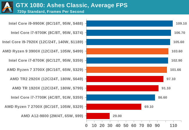

Ashes of the Singularity
Setting 3900X to 100% we see:
i9-9900K = 105 %
i7-9700K = 103 %
Ryzen 9 3900X = 100 %
7-8700K = 99 %
Ryzen 7 3700X = 98 %
i7-7700K = 84 %
Going from 7700K to 9900K 25% may be gained in this RTS game.

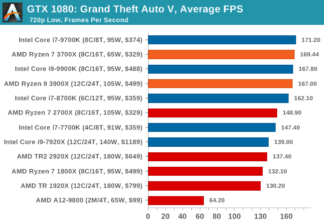

GTA-V
i7-9700K = 102 %
Ryzen 7 3700X = 101 %
i9-9900K = 101 %
7-8700K = 97 %
i7-7700K = 88 %
About 15% can be gained going from 7700K to 9900K.
