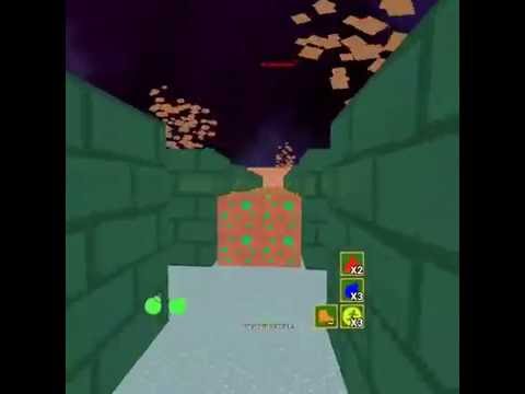

I got the feedback that my app doesn't run at a consistant 60fps and I'm a bit confused by it. I recorded my game-play for awhile and didn't catch any drops in FPS below 60fps.  Are the submission folks testing FPS differently from how we're doing it?
Here's my video showing it in headset using an S7 - which the feedback said it didn't maintain 60fps :

    This sounds like a mobile app, so I'll move to the mobile dev section. Did the email you receive mention any particular part that was choppy? Because it's possible it's running at 60fps for most of the time, but even one intensive scene or level could cause it to fail.

    Have you tried doing a wireless adb logcat of the game running to observe the frame rate statistics displayed there? Maybe there is a slight drop somewhere that isn't picked up in the GUI FPS counter you are using. Or maybe they made a mistake about which device type had the FPS issue.

    No mention of what part of the game that was choppy. I've been doing optimization passes and have been in-game for over 40 minutes at a time.
