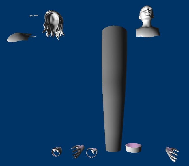

I am on a DirectX 12 rendering path with Visual Studio 2015. That means setting up the Mirror sample with VisualStudio 2013 is a real pain I rather would not do. However, in order to better understand the Mirror sample I would very much like to have the excecutable available. If that is not possible I guess a video showing the demo would also help a great deal.
As you can see I have no problem downloading the Avatar meshes from Oculus, but still have some questions on how the different API in the AvatarSDK work together. Having a working demo, not only the source code, would be very helpful.

    Thanks for the help. I got it to work for Visual Studio 2015 by changing generate_projects.cmd to this:
    @cmake -G "Visual Studio 14 2015 Win64" -H. -BVS2013
    My error obviously was to assume cmake would be clever enough to use whatever Visual Studio version it finds on my machine. As I do not have VS2013 the above change was necessary to let cmake work together with VS 2015.
