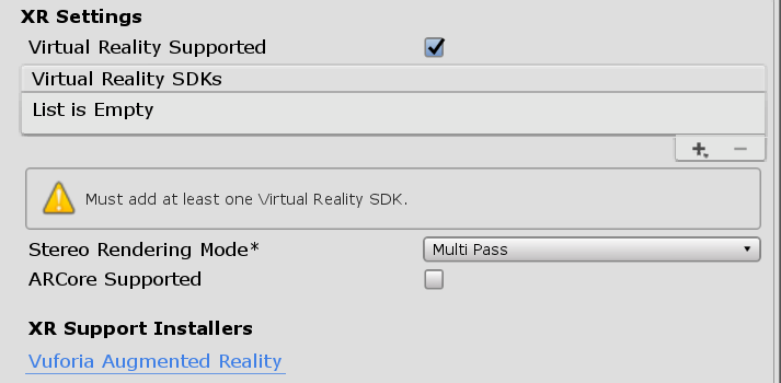

can not use VRTK
1364887753113648877531 Posts: 5
Exception: An SDK Setup from the provided list could be loaded, but the device is not in working order. There are no other Setups in the provided list to try.
VRTK.VRTK_Logger.Log (VRTK.VRTK_Logger+LogLevels level, System.String message, System.Boolean forcePause) (at Assets/VRTK/Source/Scripts/Internal/VRTK_Logger.cs:174)
VRTK.VRTK_Logger.Error (System.String message, System.Boolean forcePause) (at Assets/VRTK/Source/Scripts/Internal/VRTK_Logger.cs:130)
VRTK.VRTK_SDKManager+<FinishSDKSetupLoading>d__96.MoveNext () (at Assets/VRTK/Source/Scripts/Utilities/SDK/VRTK_SDKManager.cs:943)
UnityEngine.SetupCoroutine.InvokeMoveNext (System.Collections.IEnumerator enumerator, System.IntPtr returnValueAddress) (at C:/buildslave/unity/build/Runtime/Export/Coroutines.cs:17)

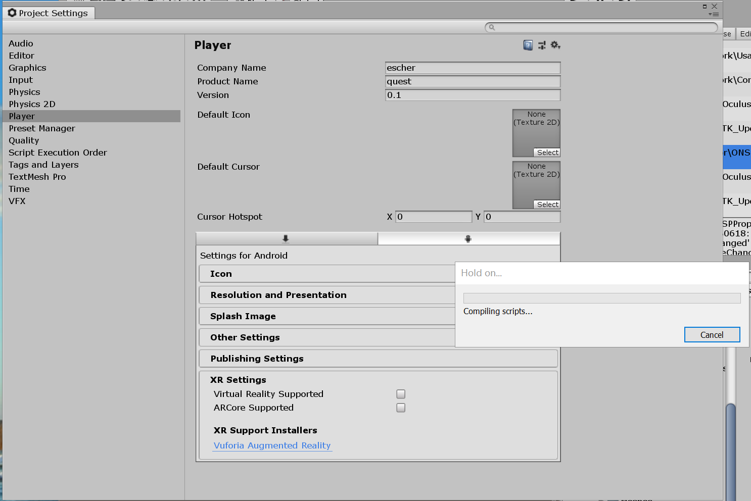

When I check virtual reality support box,and choose  oculus,it will work like the first picture,and then,it like the second picture:
I don‘t konw why,oculus just can't be choosen.

    I don't know if that might still help, but in case someone else stumbles across this problem:
    - Make sure you've switched your development platform to Android (you can do that in your build settings)
    - Also make sure you've set up everything correctly, like e.g. the API level to KitKat and so on
    - Finally, you need to go to the VRTK SDK Manager Prefab in your scene and choose "GearVR (Android: Oculus)" from the Quick Select Dropdown-Menu.
    After that, you should be able to add Oculus to your Oculus VR SDKs in your project settings.
