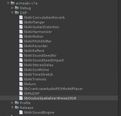

I have double checked that the libOculusSpatializerWwise2018.so is in the correct DSP folder for both arm64 and arm7 (does not work on either build target). I followed this guide:

Here is a screenshot of my folder structure for reference

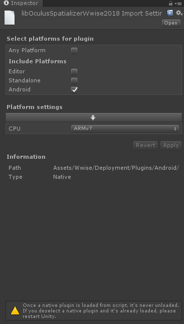

and here is where i installed the plugin to wwise

    I just tested this and found that using the default file name for our Android plugin doesn't work with Unity+Wwise. Can you try renaming libOculusSpatializerWwise2018.so to libOculusSpatailizer.so, and let me know if that works?
    If you can confirm this works, then I'll get the docs updated so they have the correct instructions.
    Cheers,
    Pete
  • RegularFriendRegularFriend Posts: 5
    Hey,
    So I tried renaming both the .so file itself and then the .soname property of the so file using greadelf. Neither seems to work.
    we have tried:
    -The name you suggested for the filename, unedited soname
    -The name you suggested for the filename, matching soname
    -The original name of the file, soname set to what you suggested
    none seemed to work
    Here is our modified .so file if you wanna check it out. it should have the internal .soname changed to what you said as well as the file name: https://drive.google.com/open?id=13VrIeJoFNg0nYGCM_jnBOs8LRZcv7j3p
    We used patchelf to change and test the soname without de/recompiling.
    Still get the error on startup and no specialization in builds. Not sure what's up, but we would really like to have OSP on our device as it sounds much better than other solutions we have tried. Any help would be appreciated.
    -Will
  • PetrozaPetroza Posts: 149 Oculus Staff
    edited July 2019
    Hi Will,
    So I just created a fresh project from scratch. I used Wwise Hub to integrate Wwise 2019.1.1 into my Unity 2018.2.1f1 project.
    I downloaded the 1.38 Spatializer package from the download page, put the 64-bit plugin in my Wwise installation and my Unity project. Everything works fine in editor.
    Then I added libOculusSpatailizerWwise2018.so to Assets\Wwise\Deployment\Plugins\Android\armeabi-v7a\DSP
    When I deployed on Oculus Quest the sound was playing as 3D panning not spatializing, because it didn't load the plugin properly, this is error I got in logcat:
    (Filename: ./Runtime/Export/Debug.bindings.h Line: 43)
    07-12 14:48:55.838  5456  5470 I Unity   :
    07-12 14:48:55.845  5456  5510 I AKDEBUG : dlopen failed: library "/data/app/com.oculus.unity_wwise_test-2/lib/arm/libOculusSpatializerWwise.so" not found
    07-12 14:48:55.845  5456  5510 I AKDEBUG : AK Error:
    07-12 14:48:55.845  5456  5510 I AKDEBUG : Could not find plugin dynamic library OculusSpatializerWwise
    I renamed libOculusSpatailizerWwise2018.so to libOculusSpatailizerWwise.so in Windows explorer (without changing the soname)
    Then rebuilt the app in Unity and it all worked fine. I repeated the same process with the ARM64 plugin and that worked after rename as well.
    Note: you can inspect the contents of an APK file using 7-zip, this is a good way to check if the library files are in the right location
    Let me know if it's still not working for you and we can follow up on email.
